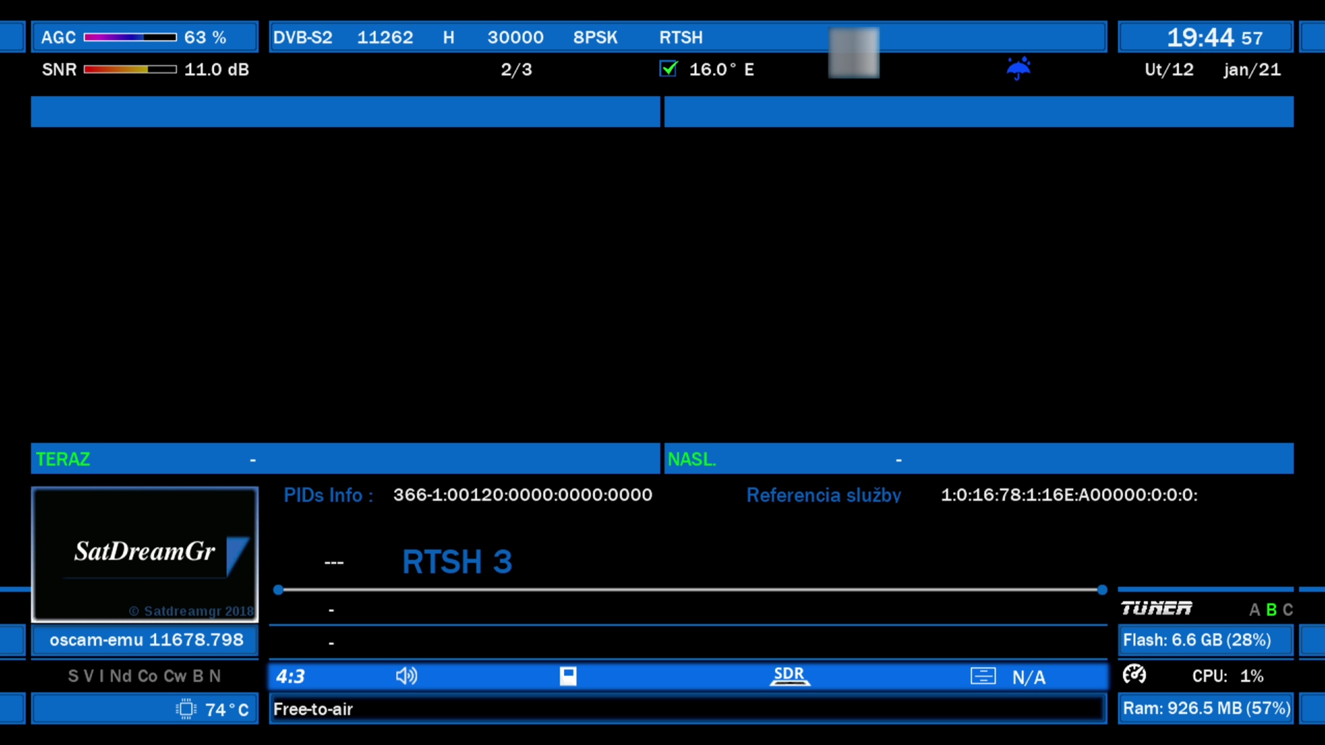

    how to repair scan on 16 East ?
    Transponder 11262.00 H and 12639.00 H use same NID/TID.
    Result - channels scan in mode One sat from 12639H show in e2 from 11262H

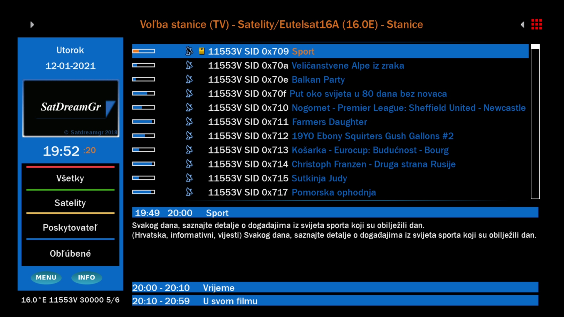

    next problem 11553.75 V scan without names

    for scan without names... it is a known story (which exist also in openpli), for the moment, just rescan only the frequency (you can use clear before scan, to delete the xxx.sid...)
    about the channels conflict, did you tried to disable the "ignore dvbs namespace sub network" ? (in customize menu...)
    disable, scan both frequencies, and enable it again...(using clean in scan, to delete the faulty scanned...)
