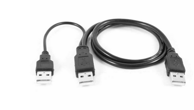

    and also... it may be a power (supply) problem.the receivers usb gives about 300ma. how many the disk needs?
    in that case, a cable like this could do the job

    Sorry for the delayed response. Don't believe it's a cable or power problem because after I did the mount -t ntfs module and formatted the drive in Win10 as ntfs, and then plugged it into the duo2 front usb port it was recognized as a read only drive.
    The supplied cable for the ssd drive is a Micro-B to USB 3.0-A backwards compatible to usb 2.0. But, as I mentioned earlier, it is recognized by the duo2 as a ntfs read only drive but not as a ext4 drive. Also, it works great as a ext4 drive in Ubuntu using the disk tool to copy or read files.
