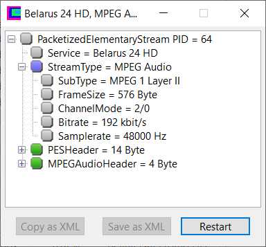

    Question Re: New SatDreamGr Images 6
    this sound not work on Mutant HD51,
    bug in HW or SW ?
    source - 11350 H - 51.5 East

    Hi, can you post a sample of the troublesome audio?

    It seems VLC has also trouble playing audio streams in this transponder. FFplay on the other hand is able to decode them just fine. So, I guess it's a software problem. Probably athoik will be able to give you more details.

    Απ: New SatDreamGr Images 6
    tsanalyze 51E_11350H.ts --error-analysis
    tsanalyze: synchronization lost, got 0x1C instead of 0x47 at start of TS packet
    TITLE: ERROR ANALYSIS REPORT
    TS:0:0x0000: No PAT
    TS:0:0x0000: No SDT Actual
    TS:0:0x0000: No BAT
    TS:0:0x0000: No TDT
    TS:0:0x0000: No TOT
    SUMMARY: Error count: 5
    Doesn't see like a valid ts file (at least not one recongized by tsduck).
    https://mega.nz/#!AAVyVSYJ!vcqwinzTN...8cQ0ZdGbZ3WY44 - try this stored in AltDVB , first stored in CrazyScan
