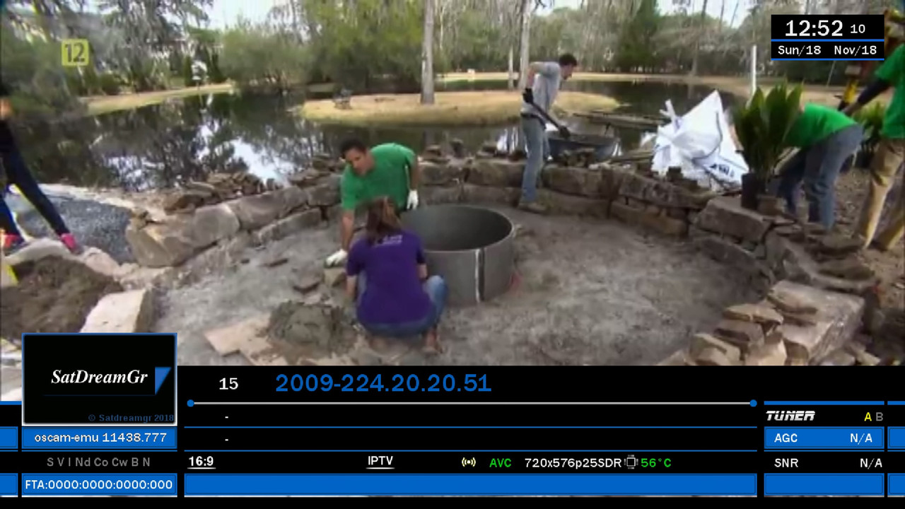

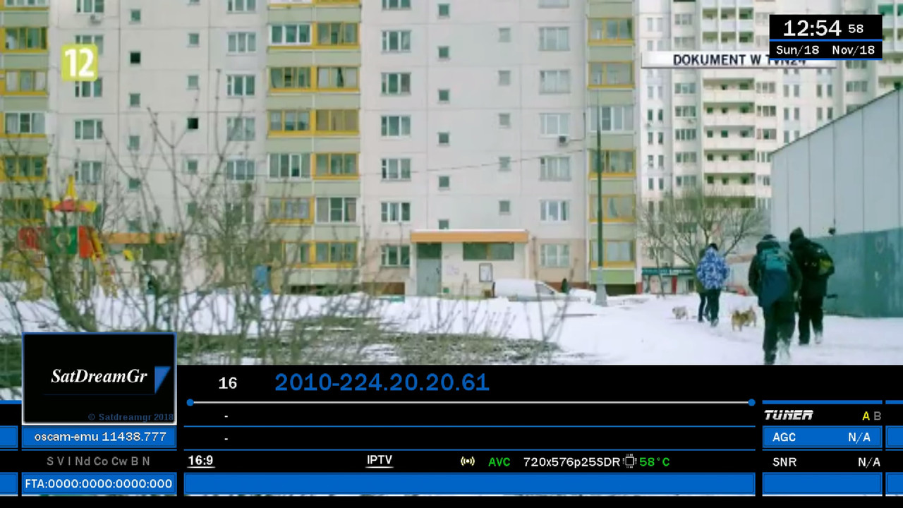

    Pids 2009 and 2010 re-appeared.
    root@osmio4k:~# dvbsnoop -s pidscan
    dvbsnoop V1.4.55 -- https://github.com/PLi-metas/dvbsnoop
    Transponder PID-Scan...
    PID found:    0 (0x0000)  [SECTION: Program Association Table (PAT)]
    PID found:    1 (0x0001)  [SECTION: Conditional Access Table (CAT)]
    PID found:   16 (0x0010)  [SECTION: Network Information Table (NIT) - actual network]
    PID found:   17 (0x0011)  [SECTION: Service Description Table (SDT) - actual transport stream]
    PID found:   20 (0x0014)  [SECTION: Time Date Table (TDT)]
    PID found: 2000 (0x07d0)  [SECTION: Program Map Table (PMT)]
    PID found: 2001 (0x07d1)  [SECTION: DSM-CC - private data section  // DVB datagram]
    PID found: 2002 (0x07d2)  [SECTION: DSM-CC - private data section  // DVB datagram]
    PID found: 2004 (0x07d4)  [SECTION: DSM-CC - private data section  // DVB datagram]
    PID found: 2005 (0x07d5)  [SECTION: DSM-CC - private data section  // DVB datagram]
    PID found: 2006 (0x07d6)  [SECTION: DSM-CC - private data section  // DVB datagram]
    PID found: 2007 (0x07d7)  [SECTION: DSM-CC - private data section  // DVB datagram]
    PID found: 2009 (0x07d9)  [SECTION: DSM-CC - private data section  // DVB datagram]
    PID found: 2010 (0x07da)  [SECTION: DSM-CC - private data section  // DVB datagram]
    PID found: 3000 (0x0bb8)  [SECTION: Program Map Table (PMT)]
    PID found: 3001 (0x0bb9)  [unknown]
    00d9:00820000:2454:013e:12:0:0
    CANALETTO2009
    p:EUTELSAT,c:031fff,c:1507d9,f:40
    00da:00820000:2454:013e:12:0:0
    CANALETTO2010
    p:EUTELSAT,c:031fff,c:1507da,f:40
    root@osmio4k:~# wget http://localhost:8001/1:0:C:D9:2454:13E:820000:0:0:0: -q -O- | dvb-ip-mpe2ts.pl -i - -s 100
    Nr. | PID  | Dest-IP-Address | Port  | Payload Type     | Channel Name
    1   | 2009 | 224.20.20.51    | 6000  | 33  MP2T      AV |
    root@osmio4k:~# wget http://localhost:8001/1:0:C:DA:2454:13E:820000:0:0:0: -q -O- | dvb-ip-mpe2ts.pl -i - -s 100
    1   | 2010 | 224.20.20.61    | 6000  | 33  MP2T      AV |
    #NAME Canaletto
    #SERVICE 1:0:1:0:0:0:0:0:0:0:http://localhost:5237/ott/1:0:C:A:2454:13E:820000:0:0:0:/2001/224.20.20.2/6000 2001-224.20.20.2 Aljazeera
    #SERVICE 1:0:1:0:0:0:0:0:0:0:http://localhost:5237/ott/1:0:C:B:2454:13E:820000:0:0:0:/2002/224.20.20.13/6000 2002-224.20.20.13 TV5 Europe
    #SERVICE 1:0:1:0:0:0:0:0:0:0:http://localhost:5237/ott/1:0:C:B:2454:13E:820000:0:0:0:/2002/224.20.20.14/6000 2002-224.20.20.14 AD Sports 1
    #SERVICE 1:0:1:0:0:0:0:0:0:0:http://localhost:5237/ott/1:0:C:B:2454:13E:820000:0:0:0:/2002/224.20.20.30/6000 2002-224.20.20.30 Fashion TV
    #SERVICE 1:0:1:0:0:0:0:0:0:0:http://localhost:5237/ott/1:0:C:C:2454:13E:820000:0:0:0:/2004/224.20.20.6/6000 2004-224.20.20.6 Rossiya24
    #SERVICE 1:0:1:0:0:0:0:0:0:0:http://localhost:5237/ott/1:0:C:D:2454:13E:820000:0:0:0:/2005/224.20.20.9/6000 2005-224.20.20.9 Fashion TV
    #SERVICE 1:0:1:0:0:0:0:0:0:0:http://localhost:5237/ott/1:0:C:D:2454:13E:820000:0:0:0:/2005/224.20.20.11/6000 2005-224.20.20.11 Euronews
    #SERVICE 1:0:1:0:0:0:0:0:0:0:http://localhost:5237/ott/1:0:C:D:2454:13E:820000:0:0:0:/2005/224.20.20.12/6000 2005-224.20.20.12 Bloomberg
    #SERVICE 1:0:1:0:0:0:0:0:0:0:http://localhost:5237/ott/1:0:C:E:2454:13E:820000:0:0:0:/2006/224.20.20.18/6000 2006-224.20.20.18 SkyNews Ar
    #SERVICE 1:0:1:0:0:0:0:0:0:0:http://localhost:5237/ott/1:0:C:E:2454:13E:820000:0:0:0:/2006/224.20.20.20/6000 2006-224.20.20.20 France24 Fr
    #SERVICE 1:0:1:0:0:0:0:0:0:0:http://localhost:5237/ott/1:0:C:E:2454:13E:820000:0:0:0:/2006/224.20.20.26/6000 2006-224.20.20.26 CRTV
    #SERVICE 1:0:1:0:0:0:0:0:0:0:http://localhost:5237/ott/1:0:C:F:2454:13E:820000:0:0:0:/2007/224.20.20.200/6000 2007-224.20.20.200 Ch List
    #SERVICE 1:0:1:0:0:0:0:0:0:0:http://localhost:5237/ott/1:0:C:F:2454:13E:820000:0:0:0:/2007/224.20.20.21/6000 2007-224.20.20.21 Fash (encr)
    #SERVICE 1:0:1:0:0:0:0:0:0:0:http://localhost:5237/ott/1:0:C:F:2454:13E:820000:0:0:0:/2007/224.20.20.22/6000 2007-224.20.20.22 NHK World
    #SERVICE 1:0:1:0:0:0:0:0:0:0:http://localhost:5237/ott/1:0:C:D9:2454:13E:820000:0:0:0:/2009/224.20.20.51/6000 2009-224.20.20.51 HGTV
    #SERVICE 1:0:1:0:0:0:0:0:0:0:http://localhost:5237/ott/1:0:C:DA:2454:13E:820000:0:0:0:/2010/224.20.20.61/6000 2010-224.20.20.61 TVN24
