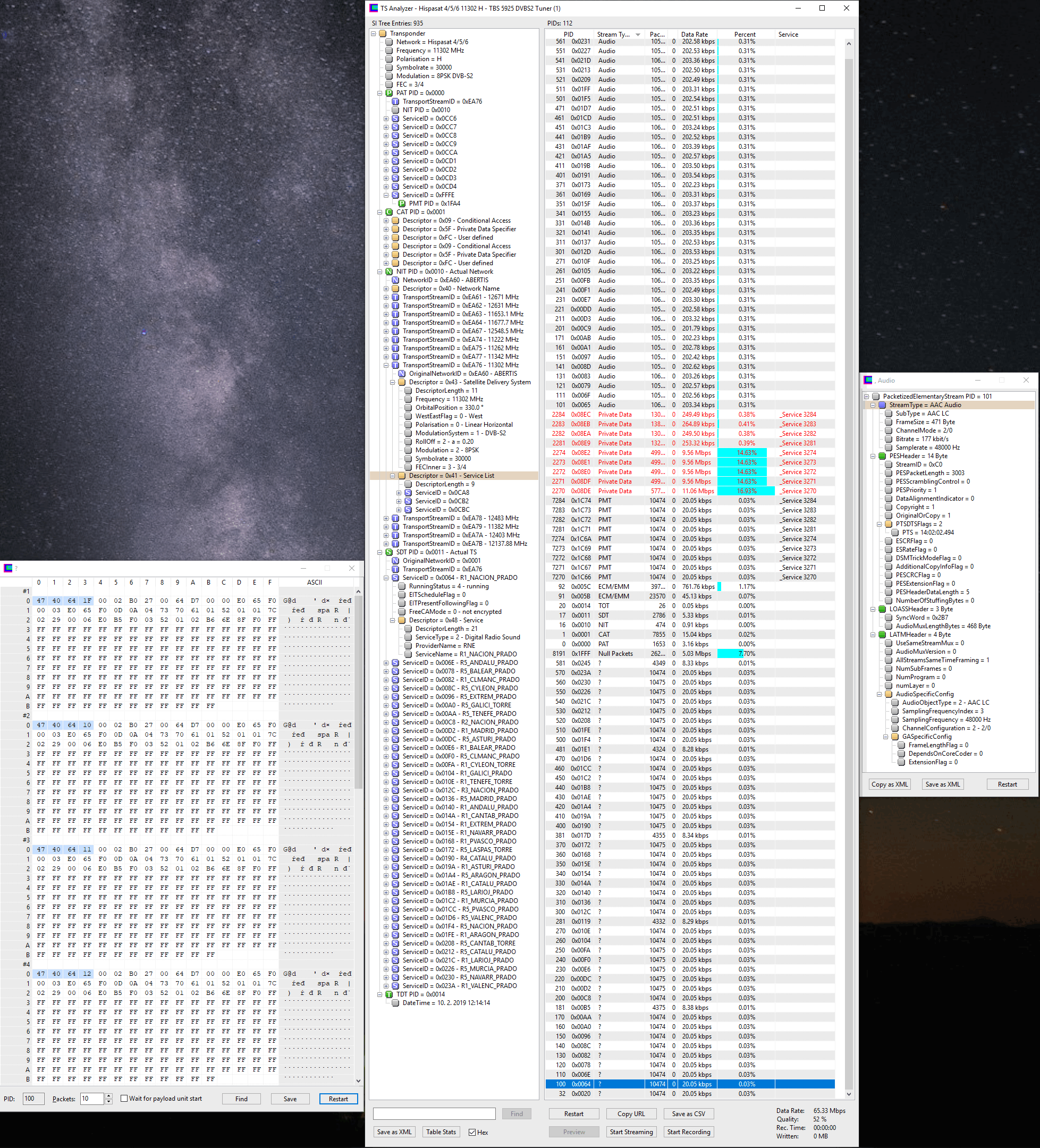

    two transponders ABERTIS use AAC-HE radios without defined in PAT, but in SDT yes (in TS transmit too PMT pids)
    1, if use f:4 in lamedb e2 not read PMT pid ?
    - if not use f:4 on screen still show window about SID not found in PAT
    - if use f:4 stream not work on port 8001

    2, if manual update lamedb better added too PCR pid or not ?
    0104:0ce42c26:ea76:0001:2:0:0
    R1_GALICI_PRADO
    p:RNE,c:120105,c:160064,f:4
    or
    0104:0ce42c76:ea79:0001:2:0:0
    R1_GALICI_PRADO
    p:RNE,c:030105,c:120105,c:160064,f:4
