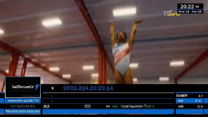

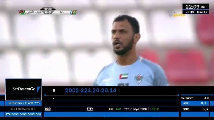

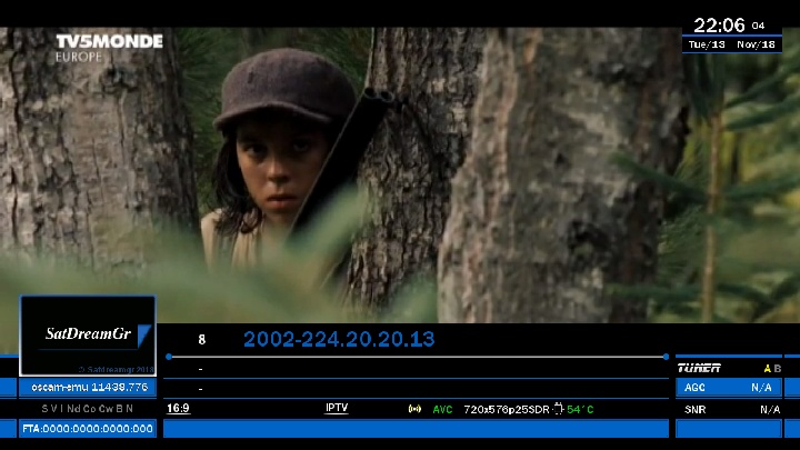

https://i.postimg.cc/9QRqdqTw/1-0-1-...1113220605.jpg
https://i.postimg.cc/TPc2gRkW/1-0-1-...1113220903.jpg
https://i.postimg.cc/SKcdGP89/1-0-1-...1113221235.jpg
https://i.postimg.cc/KYVNx22C/1-0-1-...1113222304.jpg
PIDS 2001, 2002 seem to work. PID 2010 stream 224.20.20.60 also seem to work.

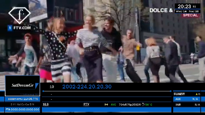

4 | 2002 | 224.20.20.30 | 6000 | 1 reserved A | -> with v0.6 ok (FTV)

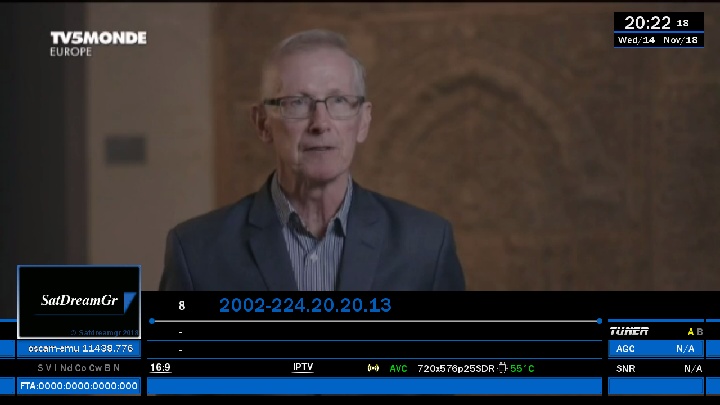

And then it works! (much much better than getting pixelation!)Code:#SERVICE 1:0:1:0:0:0:0:0:0:0:http://localhost:5237/ott/1:0:C:A:2454:13E:820000:0:0:0:/2002/224.20.20.13/6000 2002-224.20.20.13
#SERVICE 1:0:1:0:0:0:0:0:0:0:http://localhost:5237/ott/1:0:C:A:2454:13E:820000:0:0:0:/2002/224.20.20.14/6000 2002-224.20.20.14
#SERVICE 1:0:1:0:0:0:0:0:0:0:http://localhost:5237/ott/1:0:C:A:2454:13E:820000:0:0:0:/2002/224.20.20.30/6000 2002-224.20.20.30

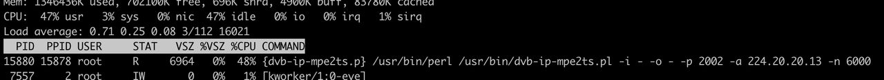

But is not 100% stable due to high load, somebody should convert this perl in C/C++ in order to make it faster! (no idea if there perl can run scripts "faster" -O3? )
https://i.postimg.cc/90Gnb6Xw/Screen...t-21-19-54.png
https://i.postimg.cc/4NQ09RFr/1-0-1-...1114202218.jpg
https://i.postimg.cc/Qx3PCdSQ/1-0-1-...1114202258.jpg
https://i.postimg.cc/mkxnQL4G/1-0-1-...1114202331.jpg
Thanks to xosef1234 for his great job!
